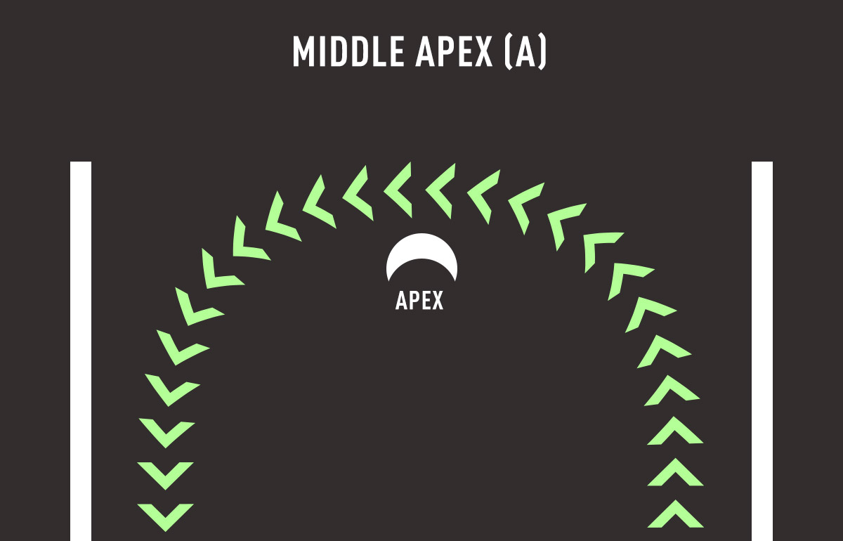

The apex in the middle of your trajectory. (A)

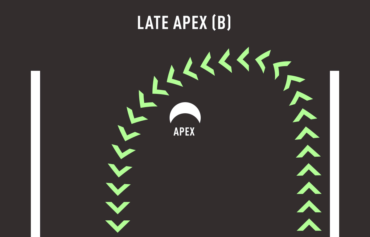

The apex on the latter part of your trajectory (B)

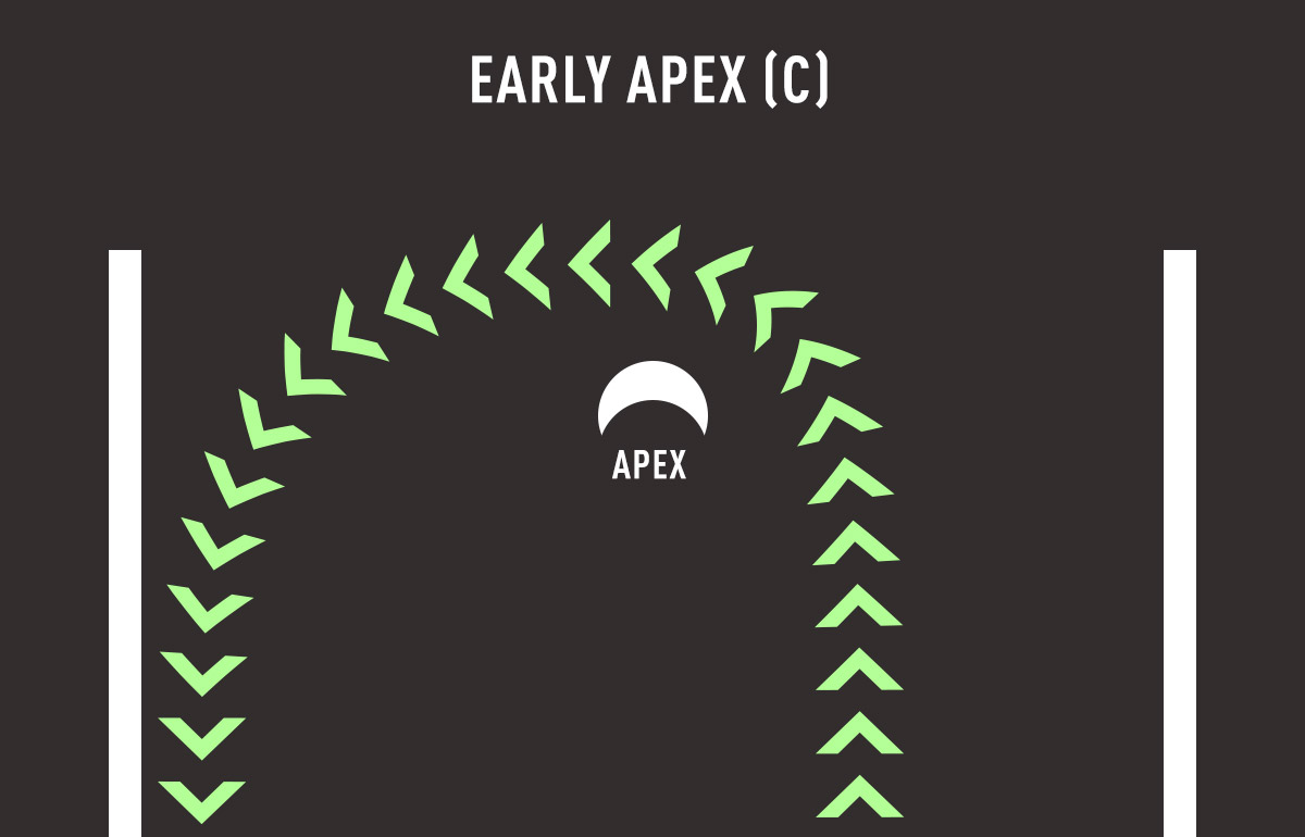

The apex on the early part of your trajectory (C)

Play with tyre pressures (I like to start around 30psi), try off camber corners. Different types of corners suit different trajectories, for example off camber bends often suit a later apex (B).
