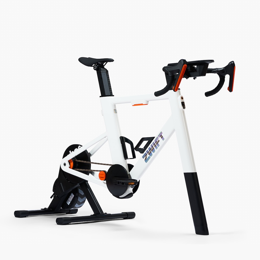

Zwift Ride V2 with KICKR CORE 2 offers an all-in-one, complete setup to unlock the best virtual experience in the worlds of Zwift and ROUVY. The proven KICKR CORE 2 smart trainer sets the foundation for responsive resistance and reliable power, paired with the Zwift Ride Smart Frame to enable seamless control of your Zwift riding experience at your fingertips.
Designed with simplicity in mind—a single tool that stows away on the frame is all it takes to assemble, dial in your bike fit, and adjust between users. Zwift Ride includes all of the hardware you need to get started on Zwift.
Zwift Ride has been updated to include multiple crank lengths, more saddle adjustability, and redesigned, larger-diameter handlebars, making it easier than ever to get set up, get comfortable, and start riding.

  • Zwift Ride V2 smart frame paired with a KICKR CORE 2 and Zwift Cog
  • In-game gradient changes drive the trainer, up to 20% up and -15% down

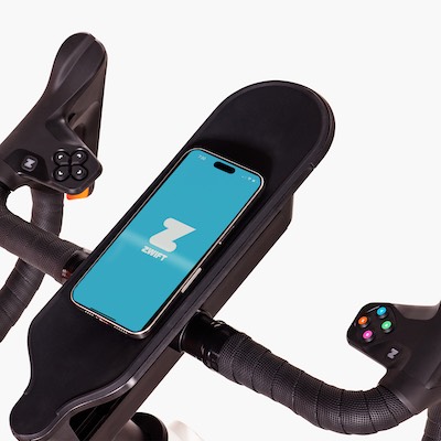

  • Handlebar controllers queue workouts, fire PowerUps and send RideOns without pausing
  • Silent virtual shifting with a customizable gear setup
  • KICKR Bridge relays heart rate and other sensors through the trainer to your app
  • WiFi and Bluetooth for faster pairing and automatic firmware updates
  • In the box: KICKR CORE 2 with Zwift Cog, Zwift Ride V2 frame, handlebar with controllers, thru axle, Allen key, frame key, flat pedals, phone tray mat, charging cable and cable tidies
  • Adjusts with the frame key stored in the frame - no tools to find
  • Flat pedals included; standard road and mountain pedals also fit

Control all of Zwift without ever taking your hands off the bars. Navigate with ease to queue your next ride or workout, shift through gears, use PowerUps, give a Ride On, and more.
